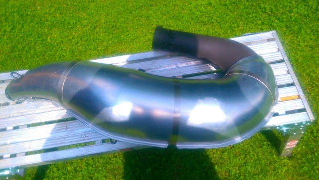

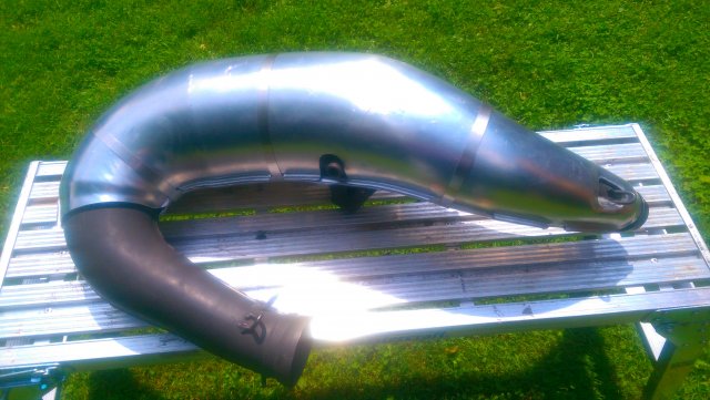

the ssi pipe mod with heat shield back on.
Looks stock except for the stainless steel straps I had to use.

Only in comparison to the Fuse600 pipes I had modded; The Axys 800 has the heat shield crimped on vs the long steel hose clamps holding the shields on, on the Fuse600. Not sure on the Indy 600 and 800? A sharp dealer/tech could spot that the shield was un crimped, and bust ya.

What are those straps and how can I get some,I'm looking into the same pipe mod and was looking for a way to put the shield back on,other than big hose clamps
The only reason I had to use straps is cause I got ssi to buy me a polaris pipe and mod it. They weren't nice to the heat shield and cut the lip all around with a grinder(not nice). Anyways I fixed it. I got two 7 inch and one 5 inch stainless steel clamp at Napa auto parts.
By the way, if you have your own pipe that your going to send to get modded .Use a small straight screw driver(plastic hammer) to lightly pry lip on heat shield apart. It takes about 15 to 20 minutes.
