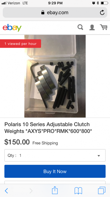

I have these weights and was wondering can weight be added to the tip and heel only ??? It’s a threaded rod in different lengths to get weight and from what I know I thought they had to be put all the way into tip and if adding more they are tightened against first one to lock them in ??? But that puts all weight in tip ? Can I use lock right to put them in heel
Yes. You can put the set screws any where you want, in any combination you want. The Daltons supplied set screws have a locking agent on them. You can put a long screw in the heel end and leave some sticking out for leverage, or pic your term for leverage. Just be sure it clears the clutch when it shifts out. You can also cut a horseshoe shape out of the clutch for that clearance. Some Poo clutchs have dimples in this are showing you where to clearance it. I believe that was originally done for heel clicker weights.
