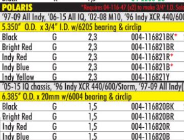

I was thinking about adding some color to my Axys suspension with some of the "swept" styled Indy Red rear axle and idler bogies.
http://www.royaldistributing.com/Catalogues/Main/2015-Fall-Winter/#172
Just wondering if diameter, bearing and width are the same and if they will work? Can anyone verify if they will work or not?
The outside dimensions of idler wheels your wanting is 5.625", it takes a 6004 bearing. As long as you can find the dimension that properly fit you can get any color you want.

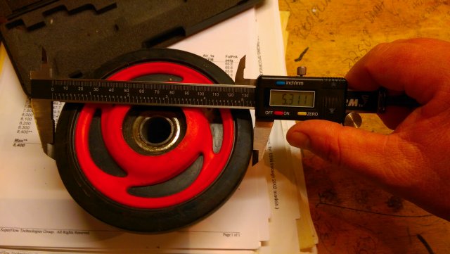

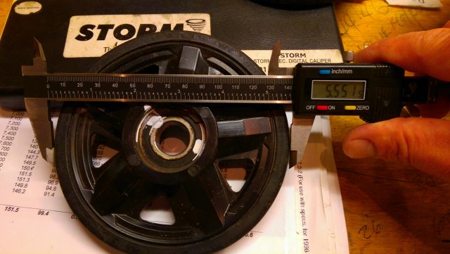

Doesnt' look like these will work then. They are 5.35" vs 5.62". They also use the 6205 bearing....but I believe there are plastic inserts that allow you to accommodate the mount. Looks like they would be about 1/4" smaller......I wonder if that is enough to be concerned about??
Rear ones should work as they are 6.38" with the 6004 bearing......
A about a1/4" smaller is to much. Less rotation on the wheels and more pressure on the sliders=more friction.
