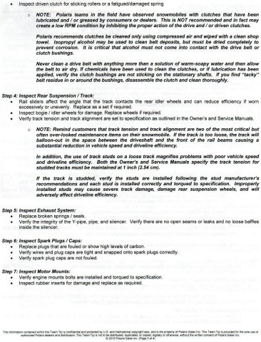

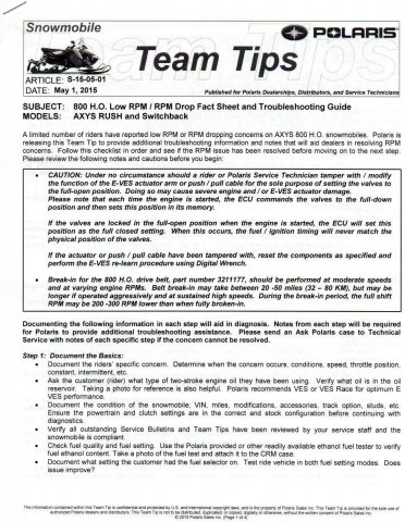

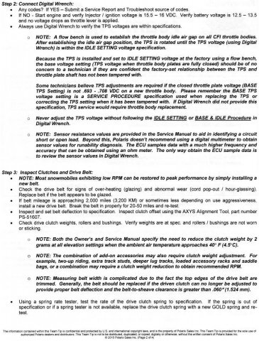

Some of the stuff that is on there seems to be a stretch. As for the oil that is used. Doesn't it have to be TCW3 rated?
Some of these things do make sense as this would apply to 90% of people out there that don't know any better.
The problem I see so far is seal from y-pipe and the pipe's themselves. These are mass produced and will be variances from one pipe to the next.
One pipe will get heat in the pipe and make power, the next won't.
TPS and all the sensor's that come on these sled's too are in need to be looked at.
I'm going to post my findings on sled's not running right soon fuse,
watch for it
watch for it
