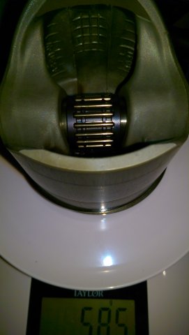

Question??
What is the weight of your 800 piston with rings,clips,wrist pin and needle bearing??
We seen that on the dyno .
Question??
Roughly 565 grams, that's without a needle bearing since our kits do not come with new ones. Weighed a stock one on the same scale and it was 563 grams.
That's a stock axys piston with everything.
I've been saying this for years. The pistons could stand to lose 30-50 grams. = less stress
Titanium wrist pins with dlc coating save 30-50 grams and could be added to your kits. I've been using them since 2000/2001.

Losing some piston weight without compromising anything is key.
Also, balancing both pistons is key
