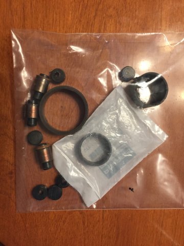

Primary clutch rebuild
Pic is of old parts off primary.
What I've noticed in the past few years. The spider buttons new aren't as thick as used ones (.250"-.245"),so you have to use the 0.002",0.006", 0.0010" spacers.
The warn bushings ID is better and smaller then new bushings ID . Not much, one or two thousands of an inch.
Just an observation as new should have tighter tolerances in my mind. Not same as used or bigger.
Seems to make rebuiliding pointless till they are really rattling then.
The part I don't like is the moveable sheave and cover bushings. They should have tighter tolerances then the used ones taken out??
Are you using oem bushings or aftermarket?
Always oem
I measure used bushings ID before I change them . Then measure new installed. The new are one to two thousands bigger ID then used. Not a big deal. But tolerances should be tighter as it's a vesple bushing and will wear.
