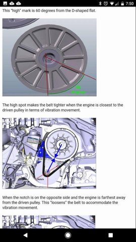

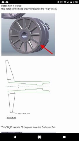

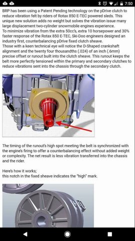

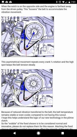

Does somebody know if Skidoo P drive can be fit to Polaris Axys Model ?
It seems that most of the snap that skidoo have is clutch related,
In théories it seems logical that it have lot less restriction than a
button clutch like the Polaris. What do you think about that ?
This is a project I wanted to do since I first seen the advertising of this new clutch design, I have talked to a ski-doo engineer twice about this setup on a Polaris, I for one don't have the money for this project but believe it is possible. The unknown things are the clutch taper and offset issues you might have. The ski-doo 600rs does not have the indexed crankshaft and clutch design that the 850's do so, that is this first positive, I for one would love to see this mod done, but not financially possible for me. Been looking for a RS p-drive since they came out, any donors?
