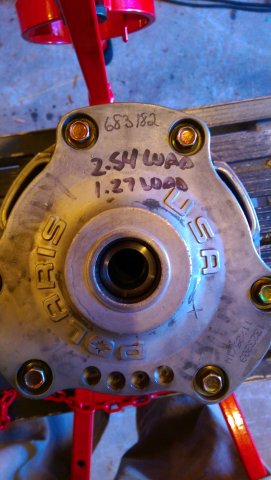

Not one Polaris primary is exactly the same. This shows force lbs.
It's supposed to be 2.50"- 1.19"
This one is 2.54"- 1.27".
In other words . If you choose a 120/300 primary spring. It's not that at all .
This one with that particular spring would be around a 105/280.
