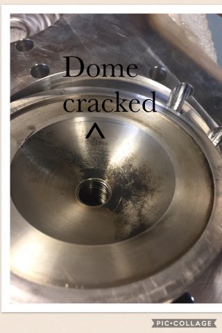

First of all, his head cover and domes were and are my nightmare. They don't seal properly and compression ratio he has stamped and what I wanted isn't 12:1, it's 12.7:1. The press in fitting for bypass wasn't even pressed in and no loctite sealant. Wtf??
Last year breaking sled in at jaws on Dyno , the head starts leaking while on Dyno. I had to take it all apart and fix it costing me 2 hours of Dyno time . Got a few det clicks on Dyno too. It's the 12.7:1 domes that were supposed to be 12:1. Using 91 octane I got det clicks on Dyno .
Then I take it out in the trails to ride and it does nothing but det . It's cuz of the 12.7:1 domes using 91 pump gas that were supposed to be 12:1 domes .
I asked terra alps to send me a new head cover and domes . I never received a head cover until a month later and still no domes. I'm pissed .
Toke the head assembly to iantomassi and he fixed it. On my dime of course . That's a 3 hour drive for me one way and the cost to fix terra alps stuff that's totally wrong. So two trips .
Plus I had to buy more gaskets now and coolant and install it all over again . All my dime and my time.
Now, our Quebec trip .We drove 9 hours to get to our spot . First half an hour I'm there it decides to over heat pissing coolant from over flow and over heating. It's cuz of combustion gasses getting in coolant because the terra alps head cover doesn't seal the domes properly when torqued to spec. I over heated it and got coolant in my motor.
I'm so pissed it's not even funny. So we're there for 7 days and 6 nights and My sled is down the first day. I went and bought new gaskets at a Polaris dealer , more coolant and installed . Everything torqued to spec and all new gaskets and coolant. Still pushes combustion gasses in coolant. Now I'm really mad .

Terra alps stuff is not 100% . So it takes a seasoned tuner or engine builder to figure all the glitches out . Teds stuff would be a nightmare for a guy that doesn't wrench. Look at my domes?? I asked for 12:1 and when I cc'd it it was 12.7:1 . It has 12:1 stamped right on the domes but it's not ??? To verify this , another race shop cc'd my heads too. This is why I was getting det codes all the time . Compression ratio was to hi (12.7:1)for my elevation and 91 octane pump gas.
Teds solution was to detune my motor by taking away timing and adding fuel?? I didn't buy a modded motor to detune it with a pcv. That's bullshit!!! . Also the squish was way to tight . So I toke my head cover and domes to iantomasi to fix as ted wouldn't do shit for me. My dime of course .
Also his leaky head cover . The head cover not sealing domes properly. All this is getting fixed by me. I asked for new 12:1 domes back in November 2016 and still haven't gotten anything.

Seems as though the head cover is out 0.003"-0.004" from being perfectly flat.
The domes are out 0.003-0.004" from being perfectly flat
The base thickness of domes vary 0.003"-0.004"
That is NOT quality and why combustion gases were getting past o ring into coolant .
Good race shops don't let this kinda work out the door , period! When there's a failure , try and get money back from an aftermarket company ??
This is all my dime and my time .

This is the fourth time taking terra alps stuff apart to fix it .
The head o ring stays in place , never cut or pinched. It's cuz of the warped head and domes the combustion gases pass into coolant .
It's getting fixed again on my dime again at a reputable race shop .
So a warped head cover, warped domes and the 12:1 stamped on it is 12.7:1 . The terra alps domes are thin in spots to were the ridges on outside are cut for coolant turbulence too. This just keeps getting better . :Banghead
I got my head cover and domes fixed by a precision machine shop that knows their stuff .
The problem with the terra alps head system is it's not perfect and won't seal . It's the process of the cnc operation that made it this way . Things weren't done properly and passed through . I can guarantee I'm not the only one with a terra alps head and domes that aren't perfect .
I'm not here to waist anyone's time. I just tell it like it is and the plain truth.
Number one problem was the head cover was out 0.003-0.004" from being perfectly flat .
Number two problem was the head cover pocket were the dome sits in wasn't perfect either and out 0.003-0.004"
Number three problem was the domes weren't perfectly flat either and out 0.003-0.004"
The domes ridge was uneven thickness by 0.003-0.004"
So, when you place the dome in head cover the dome doesn't stick out past the proper distance to get a great seal with everything being out
