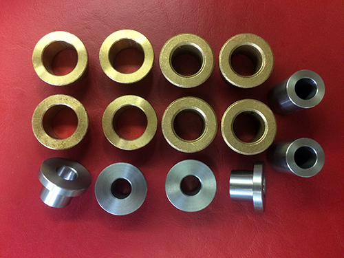

have you looked at these bushing kits from Mainway Solutions MPK02, MPK05
guaranteed to improve your ride
Indy Specialties make a kit for rear suspension also. Can buy separate or as complete kit including front A-Arm set

Replacing just the bushings is not always a fix.....Fitting the axle to the bushing will take the guess work out of it
These axles are made of Stainless Steel and machined to almost perfection.
Made in Canada and comes with 100% support.....any time
