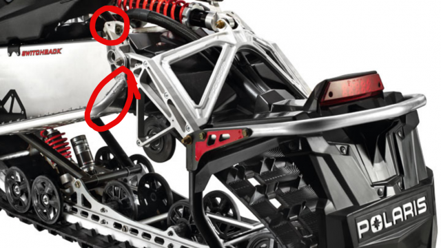

The bolt you measure rear sag from.

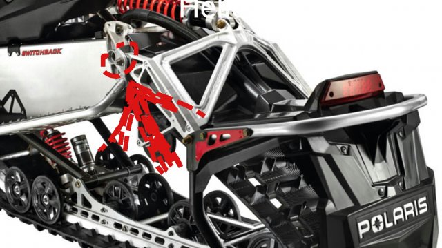

Where you want to hook, jack or pick up your sled to unload the rear. If you hook lift or jack on one side, just dont tilt it to one side artificially.

For the below comment, I'm guessing full extension means the bottoms of the carbides should still touch the ground? Seems to me if that is true, once removing jack it would immediately drop 3-4"+??
I hoist from the K brace center and that seems to take load off the rear shock...
"1. Jack or hold the front at full extension and measure from a spot on the bumper to the ground. Then gently set the front down without bouncing it"
