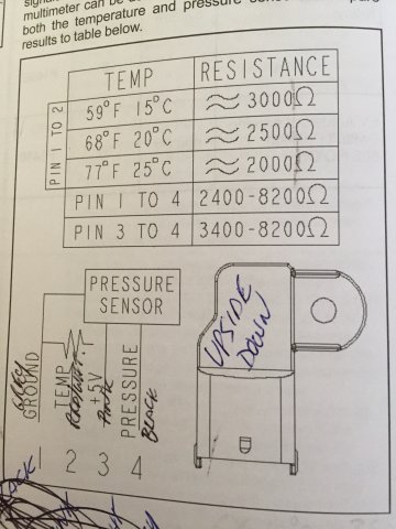

I've put an 800 ohm resistor on and cools down by about 15 degrees c
Pins 1&2 is temp and is 2000 ohms @ 25 degrees c stock.

Now, a resistor that I have tested is 817 ohms and makes it read 15 degrees Celsius cooler. This can been done also. But I don't wanna go this route.

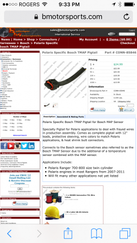

Careful - they don't give those T-Map sensors away cheap.
great idea Brock has , I think the easiest way to do this is buy another tmap sensor and mount it else where away from the under hood heat. then simply pull only wires for the air intake temp sensor from the old t-map sensor leaving pins 3,4,and 5 for the baro. just extend wires for pins 1 and 2 from existing sensor (don't cut anything, attach wires so they could be put back in original connector,later on if you wish).run the two wires up to the new mounted T-map and connect wires to pin position 1 and 2. know you have a remote mounted air intake sensor..simple..From here you could manipulate the signal from the thermistor and tell the ecu the outside temp is different from what is really is and build a map from your pvc to correct the mapping.this way is more complicated but can work as well to fine tune the fuel mapping..and the sled will still compensate as the temp gets colder..are you confused yet..lol
Thanks Doc, the only reason I'm not buying another t map is cause it's expensive . A thermistor is way cheaper plus it comes with 24" of wire plus protector
Just drill a small hole, insert thermistor and fasten with sealant and rivets .
Pull ground and temp wires out of back of t map. Connect ground to new thermistor and stock t map, connect temp wire to thermistor.
