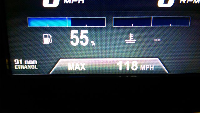

Doc, How has the 910 terra alps running? Seeing this other company there should be some dyno time!
Still tweeking it, in Canada with Brock , Imfaster, and DootoPoo, the 840 is big time durable. Been running 45-over 100 all day. Over 1k on crank know , it's perfict. No DET, same fuel mileage as before stroker. Couldent be happier with its performance and reliability.
