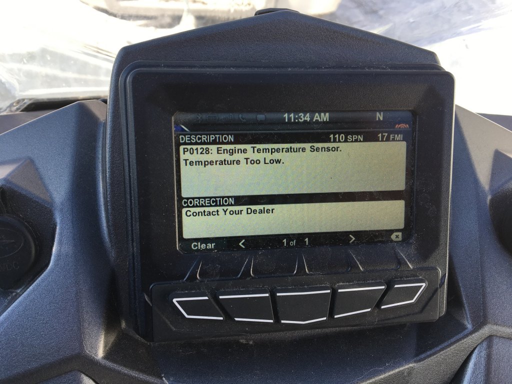

Hello Polaris Titan owners, I have a 2019 Titan Adventure with 229 miles on it that is throwing a fault code P0128. " P0128: Engine Temperature Sensor. Temperature Too Low. Contact Your Dealer. " This fault code is found in your diagnostics section of your PIDD after the "cold engine warning" goes out, on warm up. Its now at the dealership and so far they changed out the sensor and tested the thermostat and the fault code persists. Has anyone here heard of, or had the same fault code logged on their machine and had it resolved?

I am posting some of what happened today in the case of my sled Fault Code P0128. Polaris USA and Polaris snow Division based in Winnipeg Canada called me on a conference call. Apparently, the tech originally assigned to my case was not familiar with the Titans systems, and had proceeded to instruct the dealership to conduct component change outs when the problem is a self correcting fault logged when the Titan warms up. To make a very long story short, the "new" tech assigned to my case told me the fault is normally logged on warm up, but clears itself after riding for a few miles. I asked why it was there in the first place? He said it was a normal fault, nothing to worry about. He then said I shouldn't look at the diagnostic screen unless there is a "Check Engine" indication on the PIDD. I asked why the fault code instructs you to "Contact Dealer" and he again said that it was a fault that eventually corrects itself and didn't effect the sleds operation. I suggested that Polaris should re-write the program that generates a fault that is irrelevant in the first place, and then instructs you to contact dealer as a correction. I check my sled before I go for a ride, including the diagnostics screen and the fault directed me to see the dealer so I did. So Polaris was very generous, and extended my warranty for two more years for this unfortunate mistake. My sled has been in the shop since Febuary19, I should be picking it up this week. I'm very skeptical of the non answers of why the fault is there in the first place. (next time you warm up your Titans, see if you get this warm up fault too) Thanks again for replying to my questions.
I have a 2020 850 Indy XC. The low temperature red bar at the bottom of the gauge goes out between 65 and 70 degrees. On one ride the red bar came on and the temperature degrees fluctuated wildly. Turned out that the harness to the temperature sender failed. The problem is not self correcting when the engine warms up. It is not a normal fault code. Customer service doesn't know what they're talking about.
I have been informed by the Polaris Snow Division Tech, that the Fault code P0128 will remain on the diagnostics screen until the ignition key is cycled ( turned off and on) AFTER the engine is fully warmed up, not after running the sled for a few miles. Thanks for reading and your replies.
