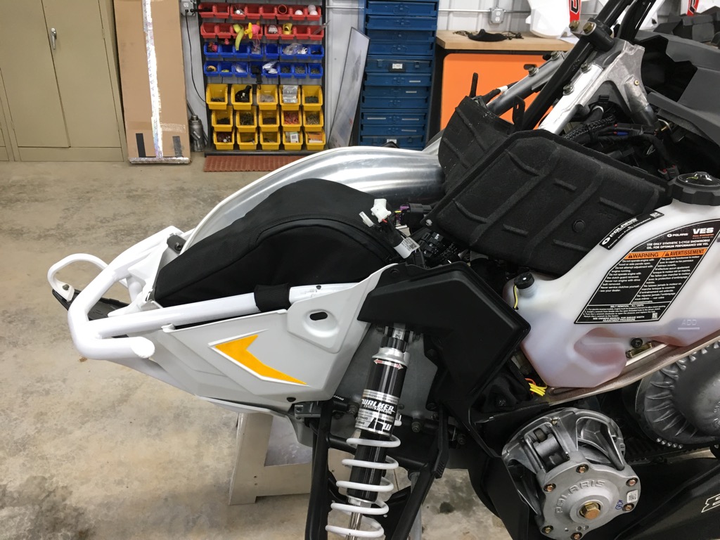

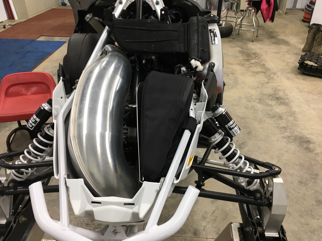

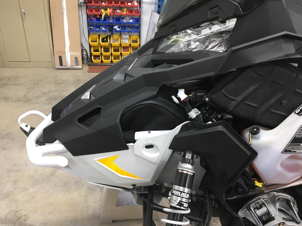

just installed polaris’ new google bag. Was an easy install. Quality seems good. Took about a half hour. I’ll let you know how it works.
Let you know after this weekend. 1st ride of the year.

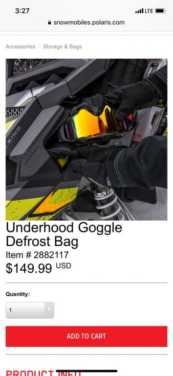

How much are those bags? Are they made by anyone but Polaris?
Works pretty good. Temps were in the teen. It was dry inside and warm. Not hot, but warm.

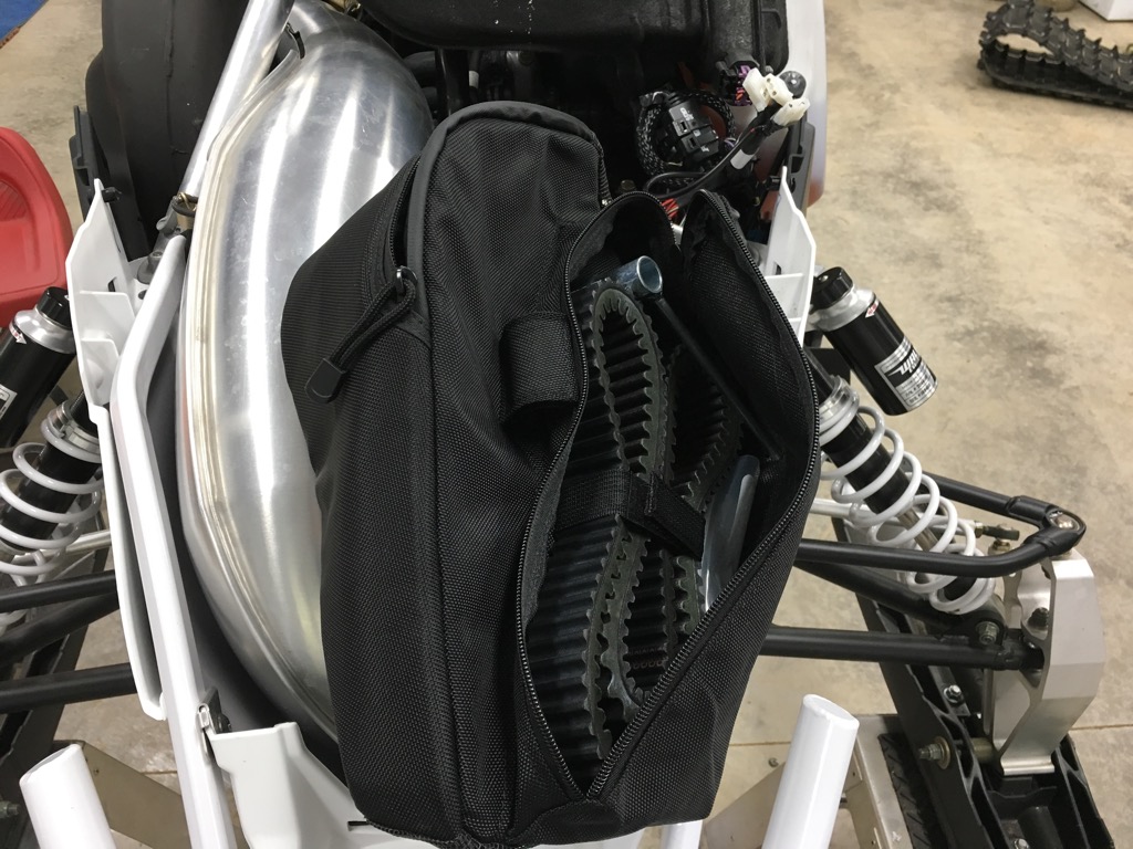

It’s worth noting that in order to install this bag you need to remove the stock spare belt holder but they supply a zippered pouch on bottom/side of the new bag to store your spare belt, plugs, and plug wrench.
After the bag installation, do you need to pull the hood off to gain access to either one of the zippered compartments of the bag?
So you can easily put your goggles and stuff in by just taking of the side panel. Getting at the spare belt and tools requires a hood removal.
Thanks for the reply. What is the part # of the goggle bag.
I've looked on the Poo accessory page and haven't found it yet.

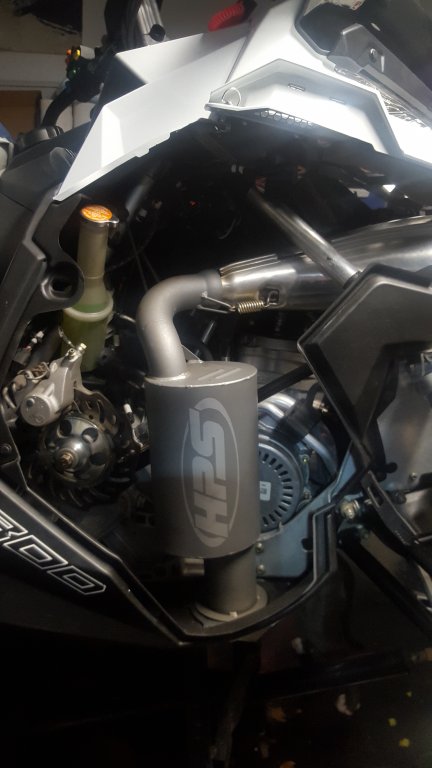

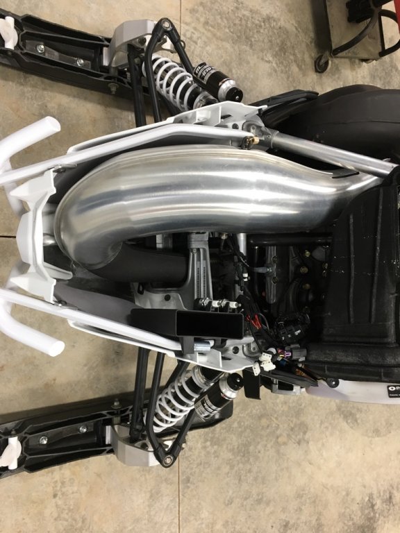

I have plenty of room after removing the stock can. I think i'll try to mount something on the crossbar over the pipe. I can probably zip tie a small bag to it.

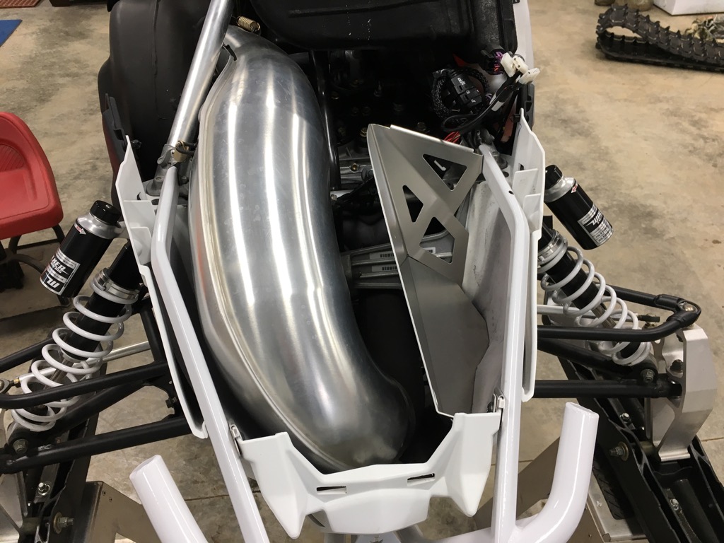

FYI if you buy the bag and don’t have a stock pipe you might have to modify the bag heat sheild depending on where EGT sensor is mounted my BMP PIPE has it coming out the side. I simply drilled a 1 inch hole in side of heat shield so I could install it
