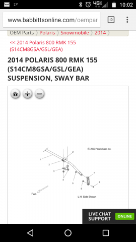

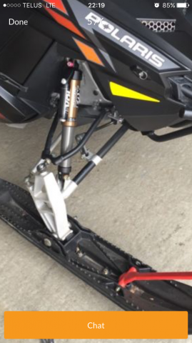

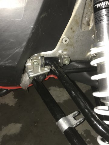

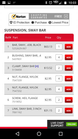

Here is a pic I seem to be missing this part and can't find it anywhere online.
2 pics are of my sled and the other is

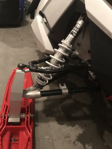

Thanks for the reply now my next question is do I need it
I don't have RMK, but I do know that many guys unhook them, obviously someone did yours.
It's there to keep the sled flat while cornering.
With it unhooked, the sled will lean side to side easier.
Makes the front suspension completely independent.
