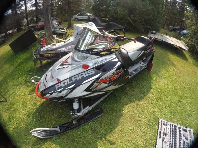

Any info on those boost bottles iv seen on these motors? My two other xc 700s one Ves one NoN ,both had one.Now i have a 2004 xcsp700 should i put one on? Or just leave it alone.

this guy i got this off says it was his wifes only,so i ran a VIN one it and i she was the only registered owner,so he didnt lie about that.
I never took the VES off yet ,but i bet they a carboned up,seems to run good,plugs are nice brown.
alittle update on my xc ,while doing the ves i notice BOTH valves are cracked,so theres basically $200 in canada here.alittle cheaper $20 off ebay.i asked around and it appears to be a flaw ,my question is will the replacements crack too? They say manufacture's date of 2005 ,oh there 5330 km on the sled so 3310 miles.
