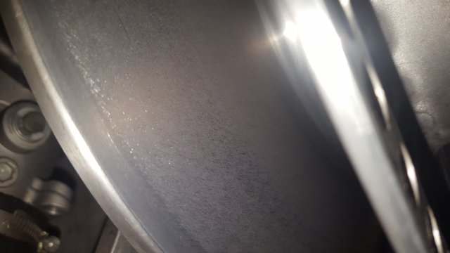

So I ran a 140 200 with the 50 44 sled ran really good but when I took my clutch off tonight too put the tied on you could see it was slipping, so if your a fat ass like me with studs id go stiffer, just my findings not bitching.

If I was sticking with tss 04 I'd go 140 220 as it looks like it's slipping a tad in the mid too full shift of the clutch.

I would run it for 100 miles or so , you deffinetly tell after that if it's working or not , my clutch had a black haze too it , so yea I was slipping the belt in the secondary, primary was spotless. ..
I'd switch it out and go a little stiffer , make sure you clean the sheaves 2 !
