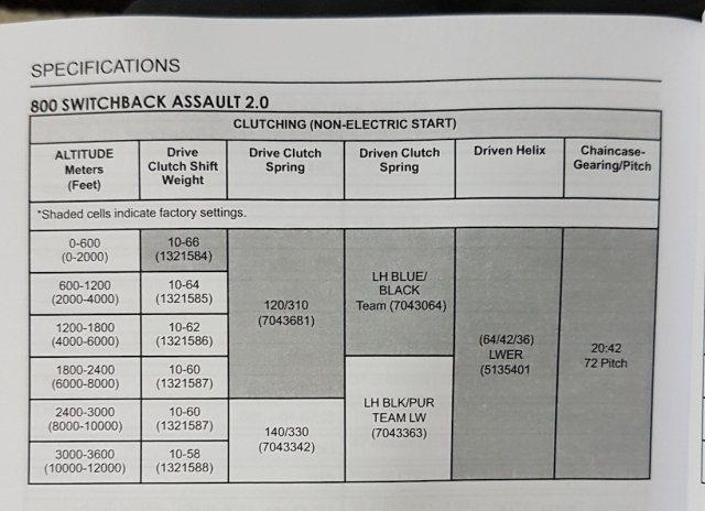

slightly better start then an Axys but 2 degrees shallower on finish. the 42 is like a 34 on an old button clutch..
Talked to my dealer and it does not have a 120-310 primary spring but the gold 100-275 primary spring.
Just looked at mine, it's gold.Talked to my dealer and it does not have a 120-310 primary spring but the gold 100-275 primary spring.
