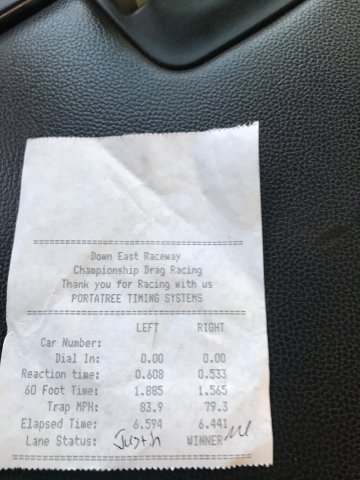

Well we got some testing in on the weekend, before we broke a tourque stop. Best run was as below winner on right.
Good job Div20
Get that 60' time to a 1.45 and you'll be even quicker et :)

Yup for sure. Moving in the right direction anyway. Started with a 6.59 down to 6.44. It's to bad we ran into troubles.

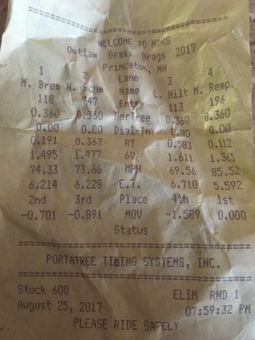

The time slip I posted is stock 600. The lane four sled was a stock Skidoo 600 RS. Ran a 5.5 in 500ft.

Anyways, on the cosdra circuit here in Canada, no 600 has went under 5.8 seconds in a true 500 foot length track. Shortening the track under 500' does make times faster though as I've seen in years past . Can't go by what you've seen for et on one track vs the others . Many race in Michigan and New York and come to Ontario and have way slower times
Brock, I here what your saying but that is my time slip printed at Princeton, MN. It was a legitimate 500 ft by the SAME organization (NDRS)that puts on haydays. It's as accurate as haydays is. A lot of big teams go there to verify as it's two weeks earlier and only short distance from the haydays site.
Well if those are you're times. Good for you, and you obviously know what you're doing. I definitely wasn't trying to put you down at all. Just stating the cosdra circuit ran by Chris always had slower times then msdra or others.When Chris from cosdra ran haydays, the times were a little slower for those years too Div20
I think this guy is just doing this for fun on an older model and would be in amateur class with trail studs, were a 6.2-6.4 is good and competitive. The 1.4 sixty foot time in your slip and 85 mph is what I was telling him to shoot for, and you're time slip proved what I was saying Div20
Forged. I see the time slip is from this year. You still on pro circuit?
That is Mike Rempel's 600 which is the fastest stock 600 in the world! Keep in mind that the 08 600 XP-RS he races is 400 lbs compared to the 485 of the XC7. FYI, I did a full tech on that sled at HayDays this year and it's 100% legit stock
