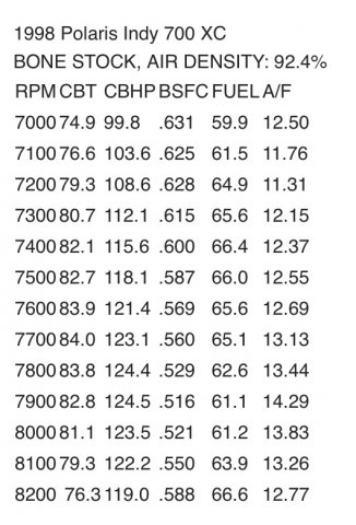

    I was under the impression that the Xc 700 only had 118 hp? Is it true like Dave said the vforce make a huge difference. I heard 5 hp on the dyno?

    they do but not legal in stock class
