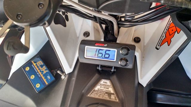

Fuel controllers; Olav is not a big fan of them till he used this one he found for my sled "EJK" fuel controller with no laptop needed the gentleman who devolved this controller was a partner at Dyno tech at one time, I am sorry to say I have not read up on this controller but I will.

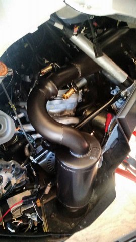

The Pipe and Can; Olav reassured me the pipe and can will be under 88db's, all Olav's cans are double lined with a stinger set up unless your looking for a race setup he makes them also, I sure hope he is right I am not a fan of loud cans and if it is loud the pipe and can will come off I work to hard to keep the trails here in Wisconsin and you guys will read about it.

Olav and I feel when the motor gets broke in HP's for this 800 HO stock will be 155 hp with his pipe add 8 hp gain and with the fuel controller and oxygen sensor +4 more he did see a +5 Hp gain but the oxygen sensor was telling him he was to close to the edge. So I will say with this set up you would be looking at 165-167 horse power.
Now for his can and and pipe its not loud at all to me it sounds like a stock 800 Cat motor.
He did run his pipe with the stock can and came up with 9hp because the stock can has more back pressure which developed a lot more heat in turn he was not a fan of the added heat build up.

Olav will be sending his pipe and can to DT for conformation Jim at told me that Olav is a good man and a truthful man and I find this to be the case myself. Olav never was a big fan of fuel controllers because he has seen them get in to the wrong hands and the end results can be divesting, now with this new system working together you will know exactly whats happening with your fuel mixture and you can adjust it on the spot with no Laptop.
The key to this whole setup is the oxygen sensor the safe area is between 13-14 on the 800 HO mine runs at 13.5 which will be all spelled out in the January issue of American Snowmobiler magazine and he did give me a copy.

Well guys I did the best I could to responsible report this back to you and I am sure some of you could translate it much better than I did. I will try to get you guys some pic's of the pipe and can and Fuel controller and oxygen sensor tomorrow and please feel free to call Olav which I know some of you guys already have. This crap is very foreign to me I miss the old days popping the hood and re jetting and looking at plugs.

Badge, that isn't your sled in the pic with the controller and digi screen is it?
