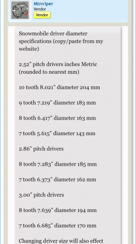

Should be 8.19 diameter with 9 tooth 2.86 pitch, Pie D equals circumference so take 9 times 2.86 equals 25.74 and divide that by 3.14 equals 8.19 which is the diameter. Pie is always 3.14
Thanks for the formula.
So 8.19(9 tooth)-7.283(8 tooth)= .907"
So it's .907" bigger circumference . So it would be half that closer to tunnel/heat exchanger (.453")
thanks for the formula .
Ok i am not very good with this décimal , it's .453 equal to 29/64 ( 7/16 strong). I will go measure the stock clearance
.453 is 7/16" strong yes
So it's 7/16" closer to tunnel/ heat exchanger
stock clearance with heat exchanger is 2 " 1/4 with the cobra track . no problem fit to avid 9 teeth . if I make the formula with 10 teeth, 10 x 2.86 / 3.1416 = 9.10. 9.10 - 7.283 = 1.71 /2 = . 858 (55/64) bigger diameter no clearance problem with 10 teeth .

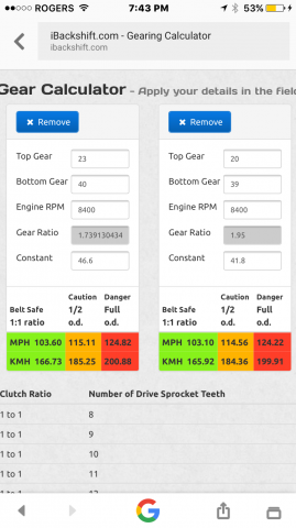

there are two main ones..better rolling resistance and the gearing change , dropping ratio and not giving up top speed from the gear down, its the best of both worlds..example if you like the 1.74 ratio and you want to keep that with 9 tooth drivers,you will be about a 1.94 ratio in the chain case..thats where your mid range will pick up huge,and turn to turn on the trail.without sacrificing top speed..

Ok!! so to take full advantage of it, we must gear it down much more than 1.73-1.76, if i understand correctly!?

I have a 1.76 ratio but wanna change to 1.74 since it seem to be a more efficient ratio, like the idea of removing rolling resistance. It's why I'm interest in this 9 tooth driver thing and big wheels at the back too!!! But i think my 1.356 cobra track with stud will be a problem for clearance...

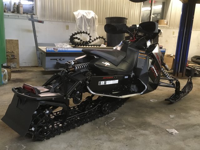

This is one step further then just 10 tooth drivers and 8 inch rear wheels.. 144 inch hacksaw in a 137 skid . I used to run 24/40 with 8 tooth 2.86.. with the 10s I run 23/43..( 1.86) so it works out to 1.67 once you factor the big drivers in. The 1 inch track is huge for acceleration to compliment the gearing and big drivers..
View attachment 2137This is one step further then just 10 tooth drivers and 8 inch rear wheels.. 144 inch hacksaw in a 137 skid . I used to run 24/40 with 8 tooth 2.86.. with the 10s I run 23/43..( 1.86) so it works out to 1.67 once you factor the big drivers in. The 1 inch track is huge for acceleration to compliment the gearing and big drivers..
very nice set up Div20
