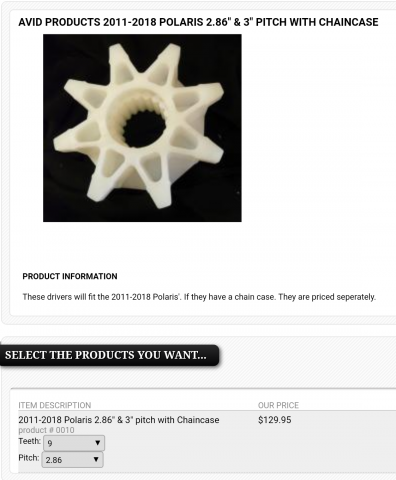

avid 9 teeth 2,86 pitch

So this is the recommended driver in the picture? I'm assuming the stock cobra track can still be used? And how would this affect clutch setup if gearing to 1.94? I tried to tell myself I wouldn't spend any money this year but this is interesting.
yes stock track can be used,if you want to run 1.94 ratio in the chain case? then the final ratio with the bigger drivers would be about 1.72 . so if your running 8 tooth 2.86 with 22/38 (1.73) now the 1.72 is the closest.those gears could be (20-39)..the ratio is up to your riding style,there are multiple gearing options..i like a much bigger bottom gear.personal preference I guess..

Sorry to bring up an old post but this seems to be the only info I can find on bigger drivers. So if I go up to a 9 tooth driver there is enough room to fit it in? It seems like there wouldn’t be enough track adjustment but I don’t know how much the driver would actually take up.
Read from the beginning. Running a bigger driver, was done with running a longer track with shorter luggs
From what I read on Docs post it sounds like the stock track can be used? Is that incorrect? I have read this entire post and I understand the track and driver swap from say a 137 to 144 but I’m wondering if by keeping everything stock besides the driver is there enough room to get it in? I know its 7/16 closer to the tunnel so is that the same amount that the track will need to be adjusted?
I honestly can't answer that, but I don't think the 137 track will work with the bigger drivers and wheels.. Not long enough. Doc isn't here any longer. He may be on FB.
