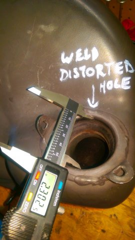

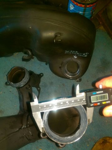

The pipe female outlet on this particular model were it joins to y pipe was out of round more than 0.060" (about a 1/16"). This is a big deal as the seal cannot make up for this amount of a gap. If it was out maybe 0.020" or under the seal along with 1500f pipe sealant can probably seal it.

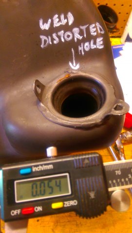

Also, the female outlet on the muffler were it excepts the pipe had a bad weld from factory that distorted the hole over 0.050" out of round.
These were all fixed and the seal is proper.

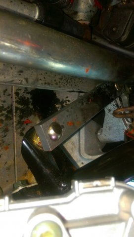

Check yours, the obvious signs are black oil inside your belly pan.
