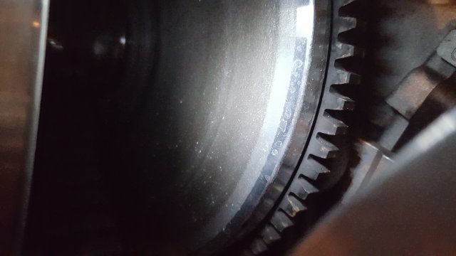

is this the belt compound on my clutch like you guys are talking about?
Ya thats,what I thought was on there. Ya the belt deff has never hit the top. Got the 1.74 gears in now and springs and helix and weights just came today
