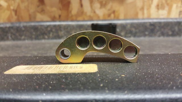

Brock I have these too play with they are 4 hole instead of 3 , each mag is 1.4 so I'm gonna try 2-2-1-2 and see what happens ...

Flash, what's the base weight??
What's the magnets weigh each?

base is 59
each magnet weights is 1.4 same as ssi
I'd try 3 in heel, 1 in middle, another in middle, and 2 in tip.
According to what you said that should be
68.8 grams .
68.8 grams .

This is flasch's weight pic. Does anyone feel that where I
marked in red could be too thin? Flasch I know you don't.
I think these are Bikeman weights?
