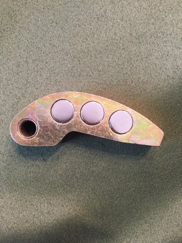

Pros800 is running..
120/310, 71.4 gram ssi adjustable, with heavy heel and tip weight.
66/44.46, 140/220
Gates belt
Balanced primary
0.020 belt to sheave
Ssi pipe mod.
1.74 gear ratio
Revving 8350 rpm all the time.
I had him set up with a 140/300 and 140/310, but the ssi heels are tucked more then most weights so it engages around 47-4800. The 120 start rate primary spring got him down to 4200 now.
It rips, he's got videos.
