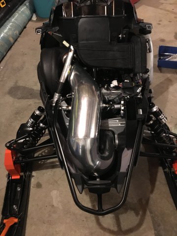

Bikeman pipe and tune! Used a little exhaust sealer on the donuts. The spring puller is also a must, makes it a lot easier and no hassle.
