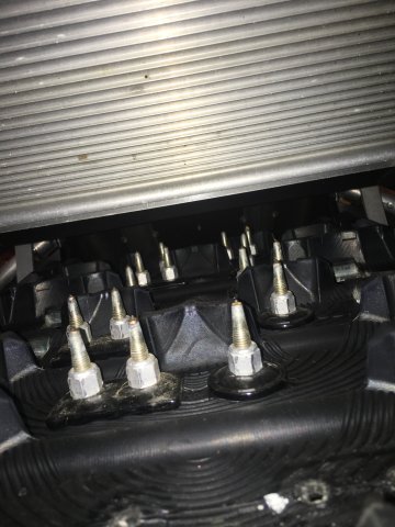

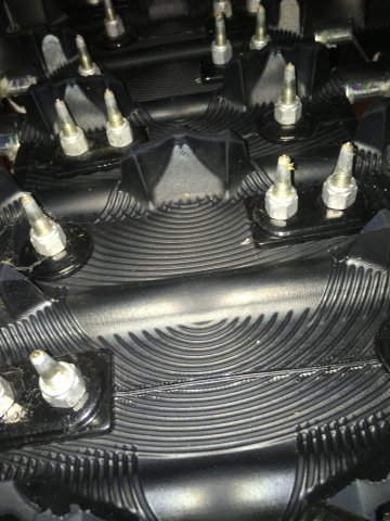

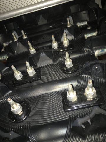

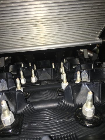

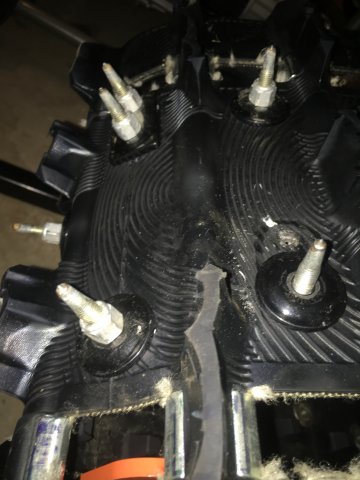

Yeah I made that mistake. Studs barely grab. This is the pattern that I have now. Starting to take the studs out

IF YOU WANT IT TO HOOK, GET LONGER STUDS.. YOUR ONLY DOWN FALL MAY BE SOME PUSH IN THE TURNS, BUT THATS WHAT YOU WILL HAVE TO SACRIFICE FOR HOOKING AND BOOKING BRO. PUT OLDER STYLE EXTRA 10 HYFAX IN THE TUNNEL COOLERS AND PIN THEM.YOU NEED ABOUT 3/8 EXTRA SO THE LONGER TIPS WONT HIT THE TUNNEL. MY SWITCHBACK HAS BEEN LIKE THIS SENCE DAY ONE, 1.640 HORNETS AND 1.860 CHISSELS WONT HIT. 1-1/4 TRACK..IF YOUR GOING TO USE DOUBLES I ONLY LIKE THEM IN THE CENTER AREA OF THE TRACK SO THE HEADS ARE NOT ROLLING OVER THE DRIVERS,JUST ME LESS VIBRATION, MORE SPEED AND SMOOTHER.

I'm going to get rid of the doubles. I'll just have 1 open drilled hole per bar which should be okay. Go with the 2-4-2-4, or 3-3-3-3, using the outside. Great advice, thanks!
IMHO - I would rather see you use the dbl backers on the inside and forgo the outsides completely. Certainly easier on the track when you avoid the outside belts. But they will certainly help your bite no doubt.

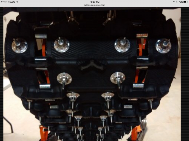

This is the pattern I ran last year. 144 1.44 triggers in a 2 4 2 4 pattern with stud stars. This Worked great for fast trail.
But when it came to hookin and bookin Doc's set up works better but you will feel push in the corners when trail riding. So you have to decide which type of riding really matters most to you .Dragging your buddies on the lake or railing the corners on the trail. It's give and take depending on the style you ride.

if you follow this link it will show you my studs at start of the season and end of season.
also another pic of longer studs with stud stars.
https://polarisstarpower.com/threads/2016-800-axys-build.260/
https://polarisstarpower.com/threads/2016-800-axys-build.260/page-6
https://polarisstarpower.com/threads/2016-800-axys-build.260/page-5
