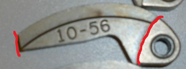

Hey Brock, Whats a good weight to get? We r gearing to 1.74 and using a gates belt. I see some talk on the daltons. A bit pricey but easy to adjust. Not sure on other types as we are new to doing our own mods.

I like different weights for different reasons.
But for fast trail and all around every person use. Hmmmm.
I like a heavy heel and tip weight. Daltons are good. I like the profile. Their a little more aggressive then the stock 10 series.
Slp makes a more aggressive profile, so does straight line. But not to aggressive that you can't trail ride them.

There are a few that I have tested. 58-44 .46 with stock spring is better then stock. I like either the 48-44 full with stock spring or 50-44 with a 140/200 spring.

A good helix for fast trail is 50/44 , like doc said .
