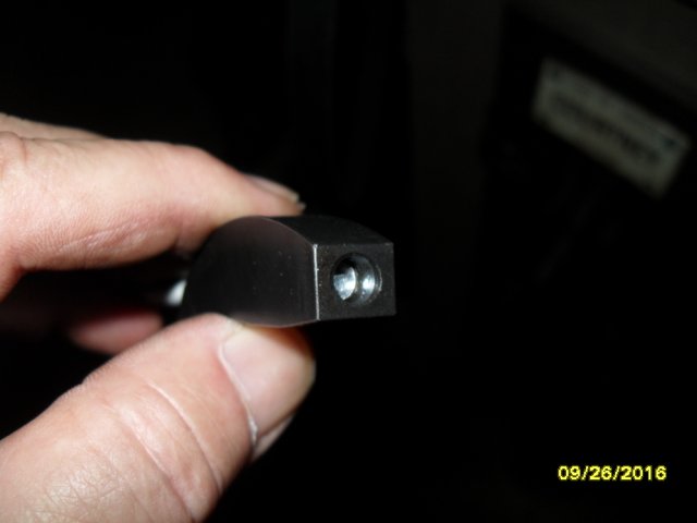

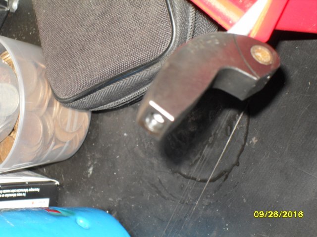

Received my QAP-3 weights today. None of them are threaded internally all the way to the tip end. Visually you can see it. Measuring a bottomed insert to the tip, they come up short by, .133, .161, .181 All 3 different. Is this right? Anyone else come across this? No way to fully load the tip this way. Best pic I can get

Yes that's the way they are, You can turn down the end of the set screws to allow them to go to the tip (or past).
also to keep them balanced with each other depth mic or caliper for the edge of the entrance hole to each weight to verify they are screwed in to the same depth
Thanks. I figured I may have to do that to the inserts, if the weights always come this way..
I read your post to fast and missed that. My 2 sets of Dalton's aren't like that. Maybe they did that to avoid the pins POSSIBLY vibrating out the end. Cant see it but hey they did put a man on the moon!

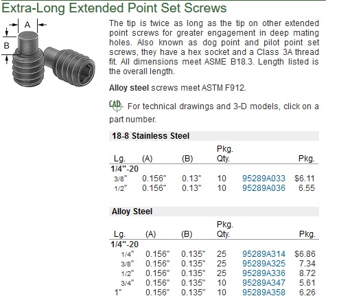

I found these setscrews at McMaster Carr. The extended tips might be worth a try to put some weigh all the way to the Daltons weight tip.Does anyone know in equal size if 18-8 stainless or alloy steel, if one is heavier than the other?
