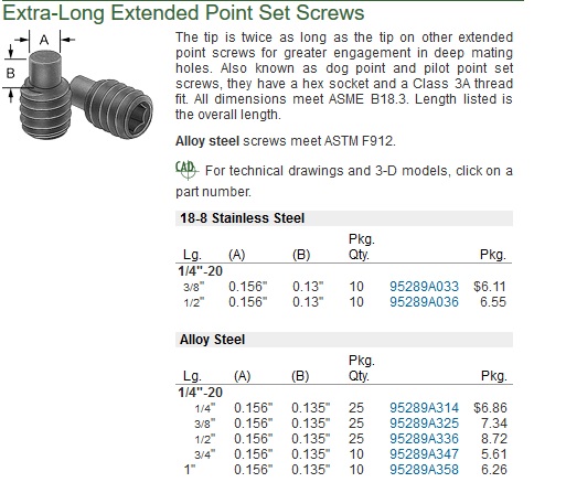

on the 3/4" set screw there should be less than .1 of a gram difference between the two materials

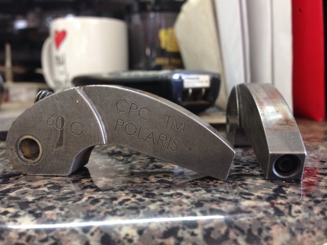

These are CPC TM weights, very similar to Daltons except the mid tip profile is more aggressive. There set at 67 total and do very well on the track loader..
So what primary spring do you end up with using those. If weighted all at the tip (which I assume is where the weight has been placed) I'd assume you'd need primary spring with a decent finish poundage to help carry it. How'd they compare to the daltons?
Right know I'm using 150-310 and most of the weight is in the base, if you look close at the pic you can see I don't bottom out the last set screw for better leverage
Ah....on second look i didnt see the set screw hanging out the back. This is similiar to how my daltons are set up. 67.6g. What rpms were u getting with the jaws pipe and this setup..
I've only tried these weights on the track loader and I like them, mine are 67 total and the profile is like the 11 series. Rpm is there depending on secondary helix,with the 70-65 full and the 140-220 it's fast on the loader 8350-8400 rpm
That is a pretty healthy helix. That helix is similiar to 52-46f is tss04 . So how would that weight compare to a 10 series? What is the weight of the hardware....similiar to dalton?
THERE IN MY 840 STROKER MOTOR, HP AND TORQUE ARE 18%-20% OVER STOCK,WAS DYNOED AT JAWS LAST YEAR. SO FAR THOSE WORK EXTREAMLY WELL ON THE TRACK LOADER,LIKE THEM ALOT.MY FRIEND RAN THEM LAST YEAR IN HIS SKS TO TRY THEM OUT,HE LIKED THEM TOO.
I THINK THE SET SCREWS ARE THE SAME, THE 10 SERIES IS LESS RADICAL FROM MID TO TIP
