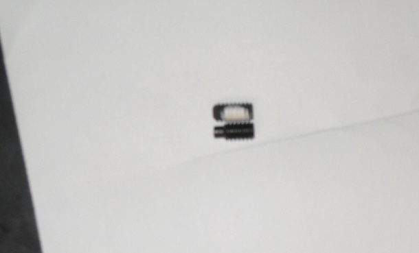

If the weight is fully loaded and you still need to control RPMS, you still have the option of changing the primary spring to a higher/lower finish rate or getting a tungsten insert. You have to remember that weight is weight also. Placement is part of the equation but doesn't control the whole shift curve.....the profile of the arm has alot to do with it as well.
