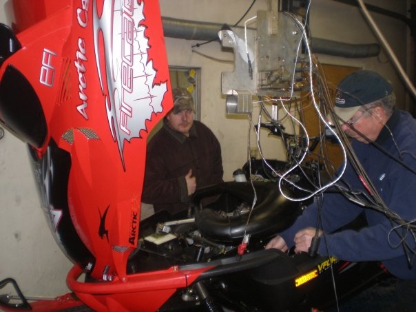

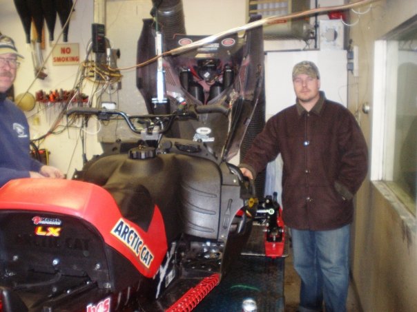

Been a long time since I've been there...I'm due for a road trip. These pics were from back in 2006 i think...I brought my Engine Tech stock cyl 800 big bore, and my friend brought his 900 Engine Tech. If my memory serves me right..my 800 made about 173HP, and his 900 about 185hp. I put about 4500 miles on the big bore and it never let me down thanks to Jim's help tuning it.
