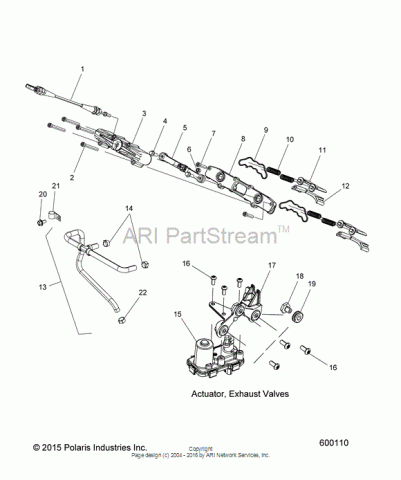

At what connection does one remove the valve cable from actuator to not mess up cable travel? Guess I did a quick look, and decided I best leave in sled to not mess anything up...
If you remove valve assembly from motor and valve cable from actuator without touching cable travel , then you don't need a relearn from dw

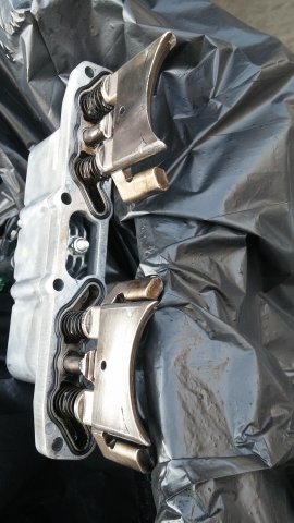

I cleaned my valves. 1500 miles. VES Gold. Came out sticking. Valves cleaned up with minimal scraping on carbon deposits. However...
At 600 miles I punched a hole in the bulk head cooler, shut the sled down when red high temp came on. No issues with motor, 8200 RPM, 109 MPH, no trouble lights, etc. in 900 miles more. Unknown to me till now, the aluminum cylinder melted to to each exhaust valve in two spots.
If you look in the cleaned up photo you can see where I removed and smoothed the aluminum from the valve. I understand why the valve cable breaks for some - that little motor must have some serious pull!
