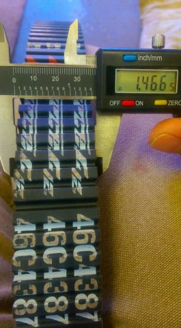

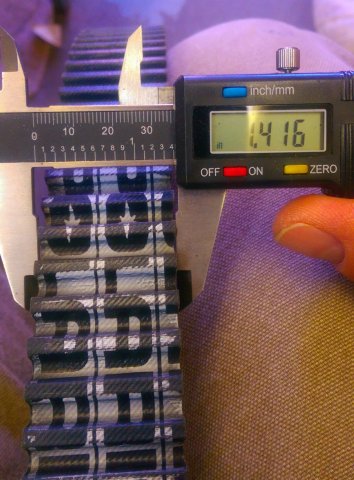

Lot of variance. Measurement's can be subjective though. One guy may put a little more/less pressure on the thumbwheel of the caliper, different calipers also. Kind of like guys all using different compression gauges and having different numbers. My used one only measure .004 less that the one Brock posted above. I am guessing his was new. My new one is .006 wider than his above.
Yes I agree.
There is no denying that fact.I use the same pressure resistance equally on all as I'd only be fooling myself.:cool:
But if you use the same caliper on different belts and find the new polaris belts are consistently 0.050" narrower is a big deal.:rolleyes:
By the way, polaris belts have been no wider then 1.42" for 10+ years brand new. Also making the primary's safe so it only achieves 1:1 at most and no over drive without machining it. Liability comes into play here it seems.

View attachment 387 View attachment 388
The measurements don't lie.
0.050" wider is huge brand new. I'd say 3+ mph on top for guessamation from my findings over the years.

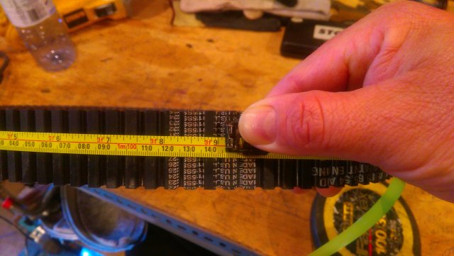

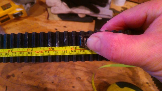

As you can see, I like to measure the length of belt too.
I think the point of measuring gaps,lengths,compression etc, is use the same tools consistently, and same methods. Slightly Differing numbers from person to person is not a big deal. Doing it yourself consistently over and over gives you your best personal baseline. Hope that makes sense.
