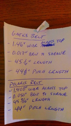

Really???If the gates is that much wider I would need to reshim my primary. For the first time I have ever seen,,,the clutch on my axys did not require reshimming/indexing. I'm right at .015" with a new 1177 belt.

Lets assume a person has two identical belts, but the pitch length on one is either shorter or longer than the other? What in theory would be faster - the shorter pitch length or longer pitch length?
Just pulled my clutch, did as written above and I can get a .025 feller guage in. Unfortunately that's as big as my set goes. Don't have a spider/ spider nut tool to pull it to remove shims. Clutch will have to stay the same until I can or parts in. Unless someone is close to Waterloo Ontario that could help a brother out?Feeler gauge. Belt has to be pushed against either sheave of the primary. I like to check them with the primary on the bench. Wrap the belt around, and tighten it with a tie wrap to make the belt as small as possible in the clutch.then measure
On a side note to this, the newer belt I have on now is 1.414 and old spare belt that came with the sled is. 1.406.Just pulled my clutch, did as written above and I can get a .025 feller guage in. Unfortunately that's as big as my set goes. Don't have a spider/ spider nut tool to pull it to remove shims. Clutch will have to stay the same until I can or parts in. Unless someone is close to Waterloo Ontario that could help a brother out?
