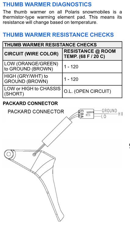

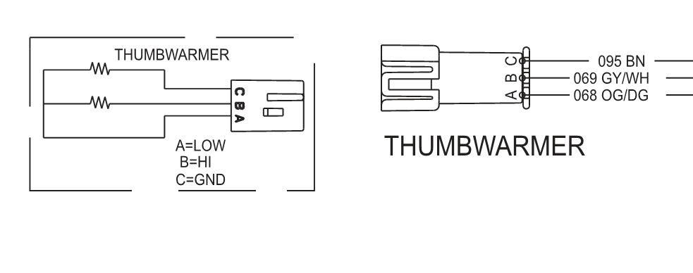

Ok I know the thumb warmers suck but I had to replace my throttle lever as I broke it. Now thumb warmer does not work at all.
I have power coming through switch properly to connection at thumb warmer harness after relay clicks in. Brown ground good.
Where I’m puzzled is new thumb warmer harness plug orange(low) and white(high) have continuity between them. Is this correct or do I have a bogus new warmer?
Original warmer does not have continuity between orange and white wires. It it only worked on high before..
please help
