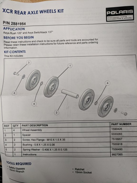

Just got these yesterday...fyi
$124.99 CDN
Those are just standard diameter.
Yes you are correct. OP was asking what we were replacing them with. But now I see how old the original post is so it's probably a moot point now on my part.
