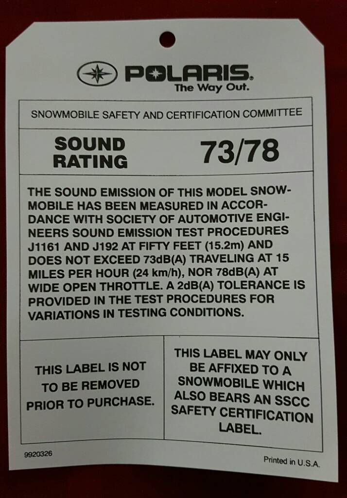

This was in the assault 800 package with sled

92 decibels is extremely loud. Some of the local race tracks limit stock cars to 92db.
The questions is, how far away is the sample taken?
yeah have to remember 1 db is 10 times louder than previous i believe.
Many states NY, MI I know for sure follow the SAE J2641 sound test standards. They just Revised it this spring/summer because previously it required testing parking brake on at 4000 RPMs with a limit of 88 db 12 feet behind and it was burning there belts because engagement comes before that on a lot of newer sleds. They changed it to 2500 RPM, and 82 db it is supposed to be done in snow covered trail like surroundings with snowmobile parking brake on and operator in normal riding position
