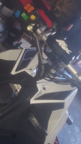

I did the same thing. Layed the template over it and marked it with,a marker. Drilled holes in the,corners and used a air and small hand saw. Then used a exacto knife to make it perfect. Drilled one hole at a time when i put the rivtes in. It holds down nice and tight.

Yea I saw your picture I think they look awesome, just from what I was reading I’m a little nervous about it, possibly having to change maps all all that
I don't think there's any issue with maps. Increased airflow is a win win.
