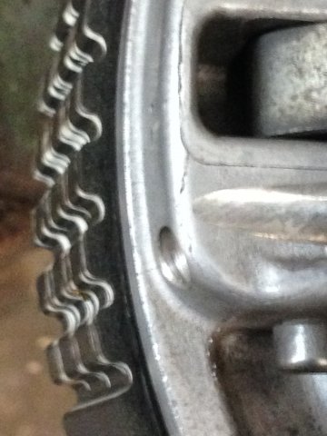

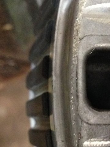

When a secondary is fully opened the measurement at the bottom is 1.150" roughly. This just happens to be the measurement of the belt at bottom . So yes, there's room in the secondary
So if you force the belt up further in the primary guys, it forces it down in the secondary too. Get the most out of the cvt system Div20

Fully closed, none of my 3 primary clutches (two machined for OD) look even as good as your 2nd picture! In fact, the top of the Gates belt was about flush with the top edge of the primary sheaves on all three clutches (pretty close to the same with an OEM Polaris belt). The one clutch is going back to the shop who did it to see what is going on and hopefully fix the issue...
