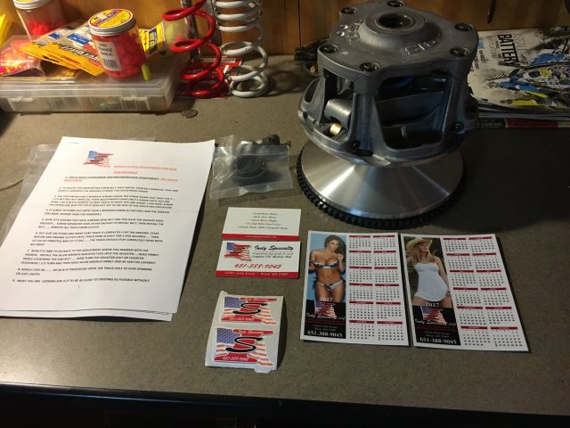

Weight shims sorry. Ya i went in for machine, balance and rebuild. 3k miles on it. Its off my switchback axys
just got it back from indy dan
Looks good Tom. If you take it apart, you'll see he added a glide shim in between the spring and the spider to prevent any spring binding. He does a really thorough job on clutches. Been using him for my last handful of sleds and been very happy with the outcome.
What's in the plastic bag? I don't recall receiving anything similar on my returned clutches. Whatcha hiding there buddy!?!?
Thats just my worn parts in the bag lol. He actually sealed then up like new lol. Im not sure cuz i havent teken it apart but just looking at it it looks like they did something in there
Does he recess the spring pocket for the extra thickness of the shim?
Most primaries I've measured inside free length from factory is well over 2.5" that Polaris has as there spec .
2.625"-2.7"I've seen out of dozens of them .
That's why I measure and supply guys with washers to make it to Polaris spec(2.5")
Yes it is, and not many are 2.5" free length inside clutch spring pockets . 1/8 " over 2.5" spec would change clutch spring lbs. rate
I explained this in another thread in here awhile back.
So that could make the gold spring about 85/260 , not the 100/275
