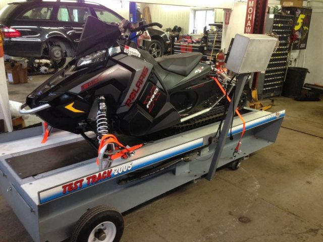

Gonna try different set ups with timing system and track loader
Thanks Joey,
Track loader.. are you talking track dyno? We have experimented with track dyno a bunch but found that nothing can replace real world Radar/GPS/Timers for acceleration testing however the track dyno can help with efficiency for top MPH.
Docs track loader with porta tree timing system Div20
But I/ we have a laser timing system and a v box sportsman to help out in the field
The trick is matching the load applied at the track to what sled will see in field for the surface it will be used on. It's tricky and results should be verified in field. Friend of mine has same set up we break our sleds in on it to set the rings etc do to control of load and speed variations.
ITS NOT A TRACK DYNO,IT CALCULATES DISTANCE AND SPEED THAT IT TOOK YOU TO GET THERE,BASED ON A LOAD,HOWEVER IM SURE THERE IS A FORMULA TO COME UP WITH TRCK HP..
