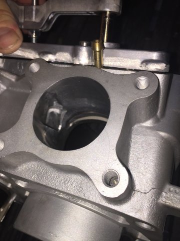

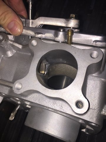

Joey, you guys machining valves to match cylinder/ports
Especially when fully open(full travel)
This ones closed.
This ones fully open
I guess I should have said stock cylinder matching ?

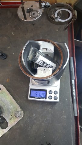

The wrist pin weighs 112.8g, and the total weight is 572g which is lighter than stock but not near your goal of 570 we actually went to a heavier wrist pin for longevity because that is what our goal is. How did you come up with a 500g goal? the total power potential is the same no matter what the weight is once RPM stabilizes. A lighter set up will rev a little faster but can also throw balance off.
I meant down around 500 grams and getting it the lowest as possible without a sacrificing reliability and strength .
Since I have great friends in the industry as engine builder's, machinist/tool and die,etc..with countless years of experience and racing , there are materials/coatings that are lighter and stronger that resist less and don't gull up and will last .
Ex: wrist pins
There is a company in Michigan making light weight titanium
The total of piston weight with everything can be down around 500 -550 grams in my mind and others . They key as you know is making them weigh the exact same down to .01 of a gram to have great balance on both( blue printing) = longevity. Spool up way quicker like the pork chop crank Polaris has and now ski doo has. And would be easier on cranks too.
Polaris has made their piston weight excessive over the years. +40-60 grams for example,vs your wosseners. The total taper is 0.020-0.022" from bottom to top on Polaris ho pistons as I just measured . Cat 800 is 0.016-0.018" taper .

My Wiseco pistons were 505g with pin and rings. Both were same.
I don't recall what stock was.
