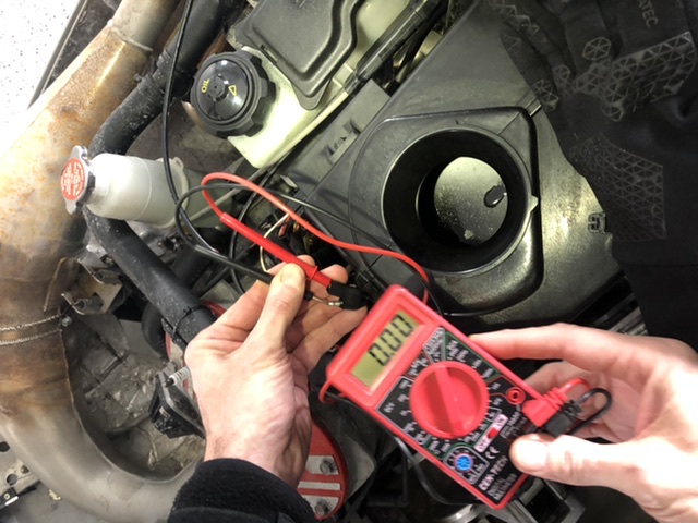

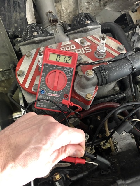

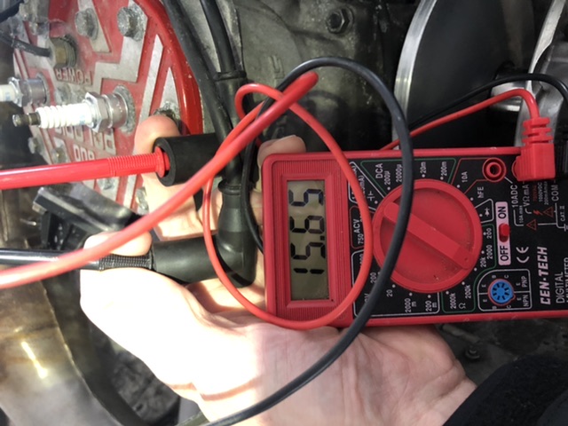

    So pictures above of readings. If I’m doing it right...they seem way off from your values

    The plug end caps should be removed from the plug wires when testing. They have resistance also. The plug caps will unscrew from the plug wire and screw back on when your done. You can also test the plug caps individually when removed from the wire, they will have 5,000 OHMS.
    All of the OHM readings are +/- 20% based on room temp. If you are within as much as +/- 40% (based on temp at time of testing) the coil is good.
    Hard to tell from the pictures what wires you are testing. If any of the readings show completely open that component is faulty.

    The zero reading on the 20k setting is of the black and white wires leading into the coil. The 1.2 reading is of the same wires at the 200 setting. Thinking that’s pretty close to open. You mentioned it should be around .3 ohms?
    I’ll check the plug wires alone again.
    you are extremely helpful thanks
