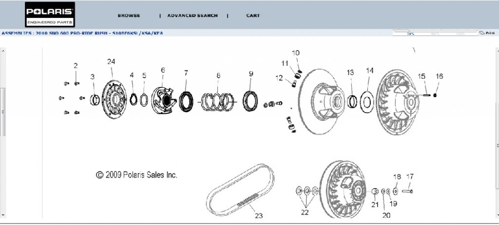

Your secondary is a P2 correct?
Possible that # 4 has slipped out of the snap ring slot because #5 needs a larger inner diameter to let the snap ring seat better. this was a problem on the P2 clutch. There is a thread here on the board about what I did to prevent the ring from popping out
