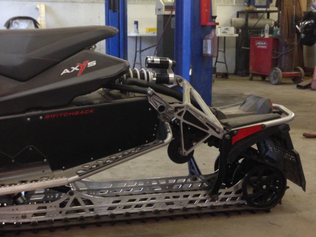

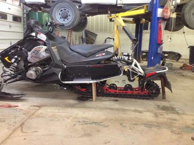

Hey guys new project this summer. This is what I do when I get board. This is a terrible obsession of mine, as is many others. So here goes , stretching out a perfectly good sled hoping to improve it. My plans so far are as follows: new rails. With no taper on the end with 8 in wheels on the back axle. Off course hacksaw 144 track. Debating on 9 or 10 tooth drivers, haven't figured that one out quite yet.10 tooth drivers would alow me to go with 24/43 ratio. Which I like, and I'm pretty sure there is room. Custom billet side X braces to move the whole skid back about 3-3.5 inches. Been taking lots of measurements and just stairing at it. Don't want it to look stupid. Carry on
First mock up

Looks like a shallow approach angle. Good for topend

By the looks of the pic, it looks like you unbolted the suspension with sled held up and slid suspension back to get measurements for your new cnc machined brackets??
Yes and the approach is not going to be that shallow, it will end up as it was stock, or slightly less. In that pic it's pulled back to tension the track to take some measurements.

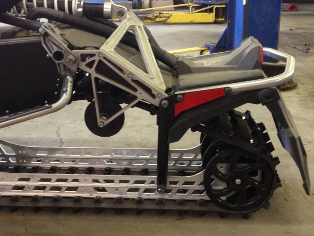

By side braces, do you mean the ones that bolt the the X brace and hold the upper idler wheels? (I tried uploading a pic with them circled but I kept getting an error...)
I feel like if you extend those you will be changing the rear geometry quite a bit as you will be lengthening the pivot point that the rear track shock swings on. Also, unless you move the front mount of the RTS, wouldn't you need a longer shock (longer by however much you extend the side braces)?

All stock locations, been brainstorming a long time. Slight extension in rear. The bigger wheels and drivers are taking up the slack of the 144.
