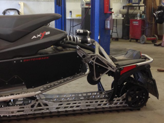

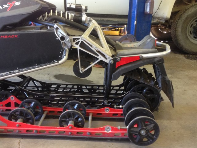

I don't see why not.to keep all the same geometry, extending the rail behind the rear suspension mount is the easiest. Also adding a slightly bigger rear wheel at the back axle would help take up track adjustment
View attachment 1187 This is all mock up, but this is what it will look like, but anodized rails for final build
It does look great! I love it when people build the stuff that's in their head!!! Keep posting updates.

Looks to me like after last mounting point the rails need to be extended and add the 8" wheels. It's figuring out the measuring.

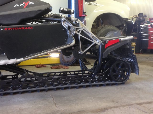

Rails are mint, Brock at IceAge was a huge help in this project. All stock mounting, the pic probably doesn't do the anodized rails justice, well worth the extra coin.
I'm not selling kits, who ever wants the rail number can just get ahold of me. I can go over what you need to buy to put it together. Someone will copy it and sell it, but that's not my intention. I just like to make things better for what I do with my sleds and then share what I find. More gratifying then a big bank account...
